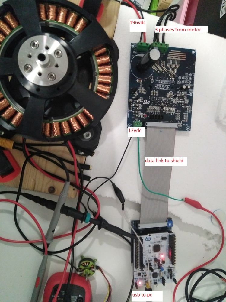

Is anyone successfully using NUCLEO-F303RE + STEVAL-IPM15B?
Javierio
I have been more than a week trying to use unsuccesfully this board combination to develop some FOC solution for big brushlesss motors.
1 REPLY 1
Saurabh SONA
Hello Javierio,
I recently used these boards to run a 110V DC motor in sensorless FOC. Works fine in my case. Can you please share the exact problem you are facing? Initially with my particular motor, the system was going into Overcurrent Protection (Fault 64) at startup. Using a higher PWM frequency and fine tuning the Torque/Flux regulator cutoff frequency (lower than default) resolved the issue. It may be different in your case.
