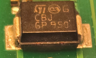

Identify this two terminal component
jfalbo
I'm trying to identify this two terminal components. It has these identifiers on it "CBJ GP 950", but there is a chance the GP is a 6P, but G looks correct. There are not cathode markings so I'm guessing it's not a diode, unless it's bidiretctional.  Please help!
Peter BENSCH
Welcome @jfalbo, to the community!
the marking CBJ stands for the bidirectional TVS SMBJ40CA.
Hope that helps?
Regards
/Peter

Thanks Peter! That's exactly what I was looking for. You are a life saver! As my kids would say, you rock.
