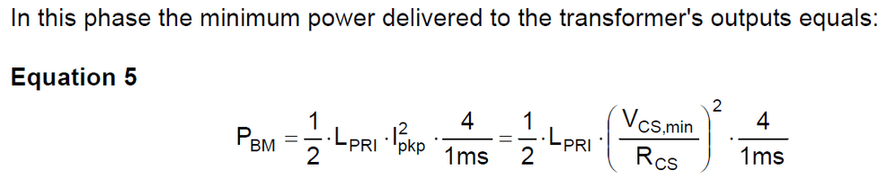

Designing an 80W power supply based on HVLED001A for 40V out at 2Amp. The issue is at lower loads it shots up to 60V. loads greater than 1 Amp it drops down to 40V. the layout is based on the edesign suite by ST., in addition, the Cclp, RCLP, HVLED001A and mosfet are heating up drastically at lower loads. Can someone please suggest the reason for overshoot as it is destroying components which can only handle 45V.

0690X000006DGMeQAO.pngThere is minimum power at burst mode, you must dissipate on secondary side.
