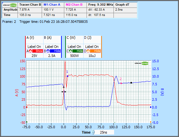

Hello I intend to incorporate MASTERGAN1 switching at 1.000MHz with duty cycle control How well MASTERGAN1 behave at 1MHz?
AEzio.1
Hello
as a resonance converter switching at 1.000MHz with duty cycle control from 20% to 50% [ symmetrical]
HV <=40VDC Output power up to 40Watts
How well the MASTERGAN1 behave at 1MHz?
Compared with TI LMG5200?
Thanks
1 REPLY 1
ken2399
I'm just using the evalmastergan1 board to do some double pulse tests. Working fine with 100ns pulses at 100V 8A, so I don't see a problem at 1MHz 40W.
Cheers!
