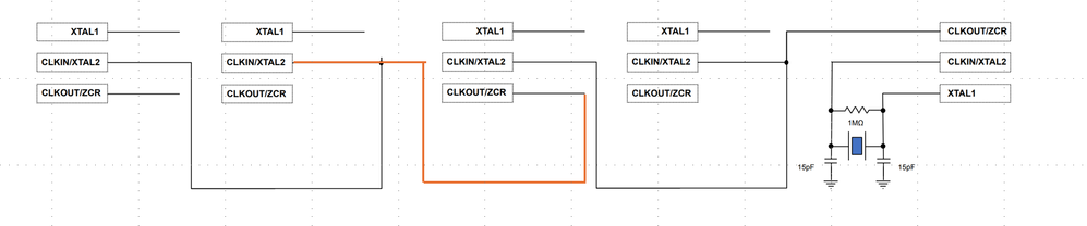

is it possible to cascade multible STPM33 Chips?
That means SPTM33 + Crystal as master -> two STPM33 CLKIN
-> Last CLKOUT -> two STPM33 CLKIN

Dear Dominik_GUDE,
You can cascade 2 STPM3x maximum.
Indeed, from 3 chipsets in cascade, the clock shape becomes deteriorated, especially the duty cycle which is too far from original 50%.
