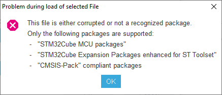

I'm having trouble loading the EEPROM emulation package into STM32CubeIDE.
I have downloaded the .zip file from https://www.st.com/en/embedded-software/x-cube-eeprom.html and tried to import it in "Embedded Software Packages Manager" but I get a "Problem during load of selected File" as you can see in the picture.
0693W000008wIIGQA2.pngI have tried downloading the file again in another internet browser and loading it but the same problem occurs.

I have the same problem, Cube Version: 1.6.0
Peter BENSCH
Please do not confuse X-CUBE-EEPROM with X-CUBE-EEPRMA1.
  • X-CUBE-EEPROM: EEPROM emulation
  • X-CUBE-EEPRMA1: software pack for the use of hardware EEPROM of type M24XX (I2C) and M95XX (SPI), which are included e.g. on X-NUCLEO-EEPRMA1 and X-NUCLEO-EEPRMA2
Currently only X-CUBE-EEPRMA1 is compatible with STM32CubeIDE and can be imported using the package manager.
The EEPROM emulation package currently only supports STM32G0, STM32G4, STM32L4, STM32L5, STM32WB & STM32WL.
