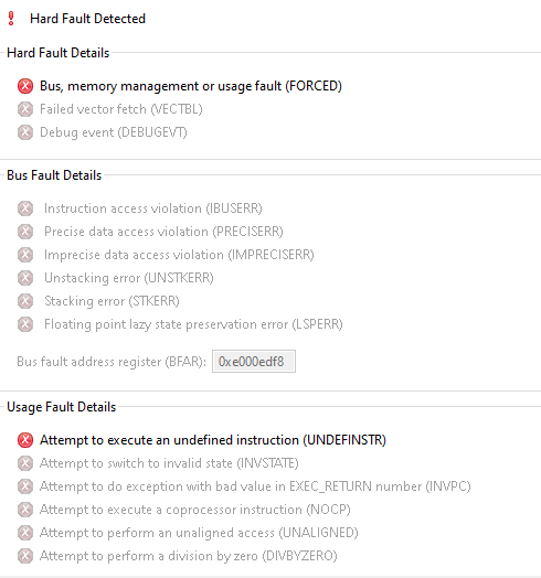

Hello, i just implemented the EEPROM Emulation example. It worked a few days perfectly.
The i added a ADC via CubeMX. Now i always enter the hard fault handler after EE_Init() was called.
Any idea? Thanks a lot

Debug the fault as usually, i.e. from the stack content find out where do the fault occur.

I am not able to handle this error according this informations.
Then learn it. It's a useful skill. Clive @Community member​  has posted hints and guidelines on this forum many times, search.
Undfined instruction execution may be trickier, though, maybe result of stack overflow, incorrectly used function pointer, etc. Usual debugging techniques apply, e.g. blocking out parts of code to find out where's the culprit, observing registers and stack to find the execution path before the fault, etc.
That you used some ready-made code doesn't mean you shouldn't to debug it as your own.

I use the EEPROM_Emulation example. When i remove the EE_Init everything works fine.

I understand, but guessing what happens in *your* code is akin to reading from crystal cube.
But I'll try: how did you partition the FLASH? Isn't your code overlapping the FLASH pages assigned to the EEPROM emulation?
@note
Before using the application, ensure that dedicated sectors for EEPROM (FLASH_SECTOR_2 and FLASH_SECTOR_3)
are erased to avoid a match with a valid page OPCODE.

Hi, yes you are right. i know that its a bit stupid.
I erased the chip manually before loading the program. Do i need to block the flash sector in the linker scipt or will the compiler do the job.
I dont find any hints in the reference manual for that.
Yes.
You need to move the bulk of your application to above the FLASH area allocated for the EEPROM emulation.
This basically is something like when you try to do a bootloader - you may find hints here on the forum.
