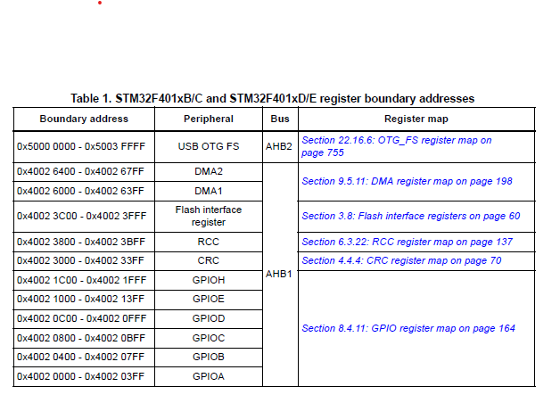

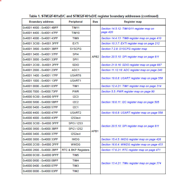

hello ,
I have this problem when im using simulator mode , when i run through my code , first its stepping through in a very vague manner , also its giving me this on the command line
error 65 : access violation at 0x40023C00 : no 'read' permission
error 65 : access violation at 0x40023C00 : no 'write' permission
so i added a random ram location because im confused on what location to use
I added this on the command line
MAP 0x40000000,0x47FFFFFF READ WRITE
but it executes a few instruction after which im at the fault_Handler location , so im definitely doing something wrong.My controller is STM32F401CCU6 series.Also why is my target option in keil Xtal(Mhz) grayed out and what ram location should i be adding in order to get rid of this problem for my board? also my processor RAM location looks as below
Thanks,
