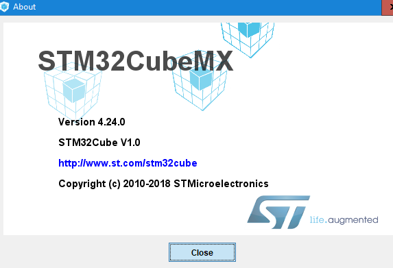

Posted on April 12, 2018 at 21:47
I have the same problem.
My system is set correctly but when I try to compile Keil progect the same error was shown:
compiling rt_main.c...
..\Src\rt_main.c(32): error:  #35: #error directive: Must specify a model name.  Define MODEL=name.
  # error Must specify a model name.  Define MODEL=name.
I follow the readme.pdf step by step and I don't think it's a wrong set of matlab or simulink.
I've also read the main_rt shouldn't be generated, maybe some problems with keil or with cubeMX?
IDE-Version:
µVision V5.24.2.0
Tool Version Numbers:
Toolchain:        MDK-ARM Plus  Version: 5.24.1
Toolchain Path:    C:\Keil\ARM\ARMCC\Bin
C Compiler:         Armcc.exe        V5.06 update 5 (build 528)
Assembler:          Armasm.exe        V5.06 update 5 (build 528)
Linker/Locator:     ArmLink.exe        V5.06 update 5 (build 528)
Library Manager:    ArmAr.exe        V5.06 update 5 (build 528)
Hex Converter:      FromElf.exe        V5.06 update 5 (build 528)
CPU DLL:               SARMCM3.DLL          V5.24.1
Dialog DLL:         DCM.DLL              V1.16.0.0
Target DLL:             STLink\ST-LINKIII-KEIL_SWO.dll      V3.0.1.0
Dialog DLL:         TCM.DLL              V1.32.0.00690X0000060AZPQA2.png
Could you help me please?
Posted on April 17, 2018 at 04:01
stefano.albertini
Could you please give me more information?
Which STM32 board you use?
If you provide a little test case if possible or at least an simulink file.
Thanks.
