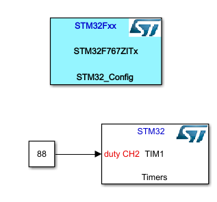

Hi, after some problems with the interface between Simulink and CubeMX, I've managed to get the TIM1 of the STM32F767ZIT working at a desired frequency and duty cycle using the next blocks:

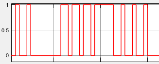

My question is, is there any way to input a PWM signal to modify the duty output of the timer instead of inputting the duty cycle to the TIM1 block as a constant? I need to use the next signal from Simulink for example to modify the duty of the TIM1.
Thanks!

Posted on February 05, 2018 at 22:25
there are 2 classic timer functions:
input Capture :  Time Capture from a pin toggled externally
output Compare: Timed controlled output to a pin. ( PWM uses this style)
If you wanted to capture the timing of an external PWM, you could use the input capture method.
You can capture on rising or falling edges or both.
Posted on February 05, 2018 at 22:28
Thanks for your answer, but the PWM that I need to use as input is not external, it is generated by Simulink.

Posted on February 05, 2018 at 22:39
If I use the Simulink model to generate the code, the PWM that I want at the output is computed on the micro so in this case there's no serial communication.
