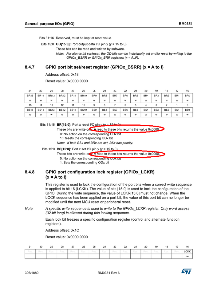

I am using an STM32L4 MCU and IAR Embedded Workbench. I noted that when I start a debug session in the register window the "write-only" bits of a certain register are field with the letter "w" (for example in GPIOx_BSRR). I was wondering if this is the behavior just in the IAR debugger or it happens for other debuggers as well and is there a way to watch these bits in particular when they are written or not.

waclawek.jan
0693W000007Dr2sQAC.pngJW
Thanks but I have already read that! that should be clear from the question and answers.
The question is: when these bits are "written" is there a way that the debugger shows a change of state or something like that? Does it depend on the debugger ?
Watchpoints are the way to catch write and/or read to some address. So why do you not use them?
@Uwe Bonnes​ I really said it many times, I don't know if you read my answers or not! I AM using watchpoints ! May I ask what is your debugger and what you get using watchpoints for example for GPIOx_BSRR  which is write-only?
waclawek.jan
The debugger, which runs in your PC, communicates with only a very tiny appendix on the ARM processor core, which can use the same bus as the processor (multiplexed in time with the processor) to access the rest of the chip. It also can stop and run the processor if commanded from the PC, and it can also stop the processor if the processor attempts to access addresses matching values in a couple of registers within the debugger. There is literally NOTHING MORE to it.
In other words, the question "can the debugger tell what was written into register ***" is literally the same, as the question "can the processor (can your program) tell what was written into register ***". The only added feature is, that the debugger in the PC can be notified when write into that particular register is attempted, if you have set it so beforehand (that's called watchpoint and that's what Uwe is talking about). Unfortunately, the processor stop happens *after* the write (quite logically so, it's a very simple system, mind), so it's impossible to tell, what value has been written, only the fact, that it has been written.

(gdb) is prompt, and the line after it is what I type; the remaining lines is what gdb writes out. "watch" is the command by which I insert the watchpoint, I enter it while the processor is stopped; "c" is for "continue", telling the processor to run, and then it stops autonomously, writes out the reason for stop ("SIGTRAP", yes gdb can be very vague as it covers a huge amount of vastly different architectures) and writes the line where it stopped. Note, that this line is *after* the BSRR write - in my source file named master.c, line 2326 is a closing bracket and line 2325 contains         PIN_SET(MODEM_POWER_ON);
which is my macro containig the write to GPIOA->BSRR.
