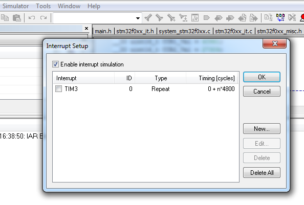

I have made a code that initialize a timer of an STM32F0 to tick every 1 ms and generate an update interrupt , and i want to test if my code work correctly
My questions:
1- The IAR startup file should be Added to my project ?
2- what is the right config to be done to simulate my code ?
2- The interrupt simulation should be enabled ?
Thank you

Does the IAR simulator support the chip in question?
You should build the code as if it is going to run on real hardware, so yes a statup file with a vector table, and calls to SystemInit() and cstartup as appropriate.
You'd need to enable the interrupt at the source, and in the NVIC.
Using a TIM or SysTick ?
Real debuggable hardware runs about $10, I know Keil has practically abandoned support for simulation

I am using STM32F051 , how can i verify that the simulator support it ?
I use a Timer to generate an interrupt every 1 ms
Is it necessary to enable
interrupt simulation to test if the interrupt occure in the exact time ( after 1ms)
Posted on December 28, 2016 at 17:02
I typically use Keil, not IAR. You could review the documentation, or speak to IAR Support staff.
I'd expect you need to check that box, and the one for TIM3, and also write code as you would on real hardware, otherwise there seems little point in having a 'simulator'. The simulator needs to reflect exactly what real hardware would do.
What would work on real hardware

Posted on December 28, 2016 at 21:02
I have exactly the same code.
what I did not understand , if i check the box to enable interrupt simulation of the Timer it looks that the timer initialization have no effect ( because with it and without it the interrupt works correctly)
If i uncheck the box the interrupt don't work
Posted on December 28, 2016 at 21:31
I'm sure IAR has some supporting documentation for the simulator, I'm not here to argue its function or usability, I'm sure it is not a gate-level / clock accurate model.
