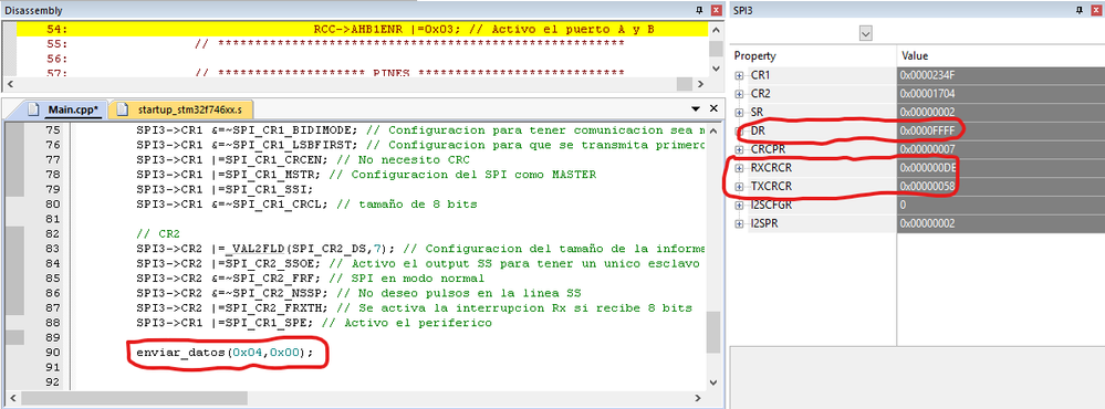

HI everyone, i'm trying to do an a SPI communication between the board STM32F746 and the MAX7219 to controller a matrix. i'm working in keil uvision 5 and programming without libraries, DMA, CMSIS or other. i programm through registers putting '1'. i want a full-duplex communication, as slave and onliy are one slave. i add the code that i do. it's on spanish that is my languaje. i hope that all can understand me and solve this. thanks

Hi thanks4opensource, thanks for answer me. I see that you are right about the baud rate, my hex are wrong, i fixed it and prove but doesn't correctly run. i mean, i use my send funtion and in the debugger on Tx Fifo i look that isn't the same. ( i adjunt the photo of the debugger) . if you see, i send 2 bytes, 0x04 and 0x00, in the right i see the state of the register, and Tx Fifo should be the same with the information that i send but it's too different. 0690X000009ZYYoQAO.png

A few things ...
  1. RCC clocks. The BR bits in the CR control the baud rate by dividing the APB1 clock which fed to the SPI3 peripheral. The APB1 frequency is set by several RCC registers, and doing so is fairly complex. Read the RCC section of RM0385. But as I said, most SPI slave chips will accept a wide range of SPI baud rates, so I don't think this is your problem.
  2. Your original post has "SPI3->CR1 |=SPI_CR1_CRCEN; // No necesito CRC", but you've circled the RXCRCR and TXCRCR registers in your debugger image, and the refer to how they differ from what you're trying to send with your enviar_datos() function. As bad as my Spanish is, I think you're saying you don't need CRC checking ... but you are turning it on by setting the CRCEN bit in CR1 to 1. Regardless, you do realize what you will see in RXCRCR and TXCRCR will not be the data you sent/received but a CRC value calculated from them?
  3. It is difficult to debug by reading the DR register in the debugger because doing so causes its value to change the next time your code read it. Every read pops one entry from the RX FIFO.
  4. I still think your problem has to do with the very confusing way the STM32F7xx SPI controls the number of bits sent and received in each SPI frame. Read what AVI-crak wrote in his "4 Data registers have a fixed size" description, the code he attached, and also the links to forum posts I included above. You're setting 8 bit frame size with your "SPI3->CR2 |=0x700;" statement, but SPI_TypeDef.DR is declared as uint32_t. To send 8 bit frames you have to both set the CR2 DS bits, and do an explicit 8-bit write of data to the DR register via something like "*((uint8_t*)&SPI3->DR) = dato;" otherwise 16 bits will be sent on the MOSI line (and 16 read on MISO) instead. This is the craziest, stupidest, most confusing, most undocumented thing I've ever seen (I wasted a week trying to find what was wrong with my code before finding the answer here on community.st.com), but that's how the STM32F7 series chips work.
