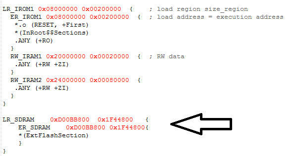

how to disable external flash programming in KEIL?
davaba
how can say to keil that ignore programming the external flash memory?
This image is the address of SDRAM in scatter file.
1 REPLY 1
Presumably it has content, so NOINIT might be in appropriate
You could create a debug script (.INI) to bring up the SDRAM
You could disable the flash algorithm associated with the 0xD0000000 region.
