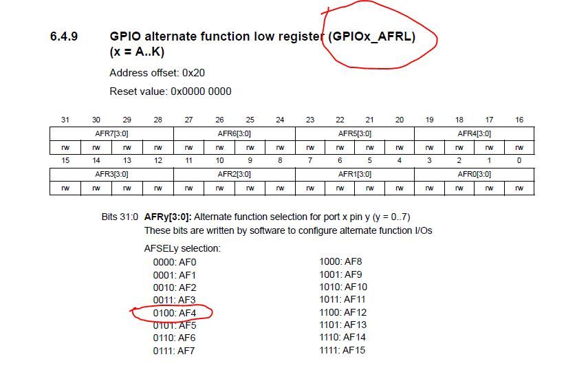

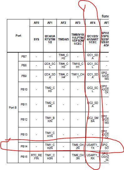

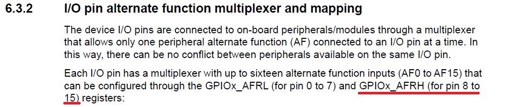

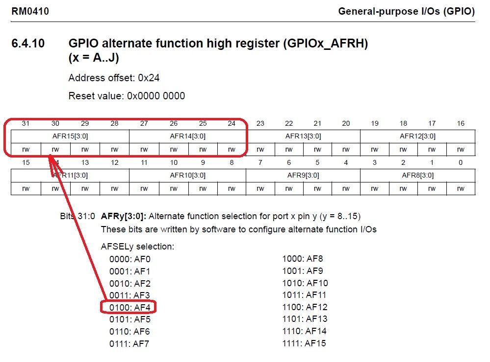

I don't think PB14/PB15 are going to be covered by AFR[0]
AFR[1] &= 0x00FFFFFF;
AFR[1] |= 0x44000000;
I would suggest first get the USART outputting from the HSI clock source, then move the the PLL
0690X000008wLuHQAU.jpg0690X000008wLuCQAU.jpgThanks for your suggestion.
the manual says for UARTTx, Alternate function is 4 , AF4, Since AF4 is in AFR[0] ,( I think so, Sorry if I am wrong)
