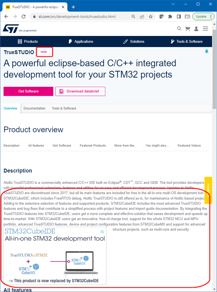

Note that the CubeIDE has replaced TrueStudio ...

Again, note that Atollic is now obsolete.
