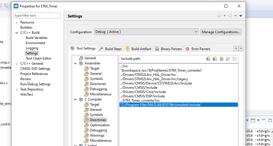

Hi @MMira.2​ ,
You are facing a problem with an include path that contains spaces in it.
This is a known issue of project generation by the STM32CubeMX tool for Eclipse based IDEs.
Simply surround this path with " and it should work.
Sorry for the disturbance.
Regards.
Cyril

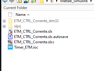

MMira.2
Now the Build Command in Simulink Model not generate all project file. Anyone have the same problem? This problem is present both Matlab 2019b 2020a
0693W000000Vvp8QAC.pngThanks Cyril,
This is the correct configuration in order to resolve de problem.
The problem recurs every time I generate new files from simulink. Is there any way to correct the bug?
I tend to just remove it manually every time new files are generated. Can be annoying at times but for my application, none of the libraries in that directory was used.
