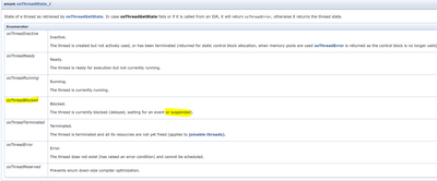

Why does osThreadGetState() translate eSuspended to osThreadBlocked? I suspended a thread and then checked its state with osThreadGetState() which reports the state as blocked, not suspended.

That's what the documentation says it will do.
https://arm-software.github.io/CMSIS_5/RTOS2/html/group__CMSIS__RTOS__ThreadMgmt.html#gad3dc89e942e38d9f3af858a0269a820d
