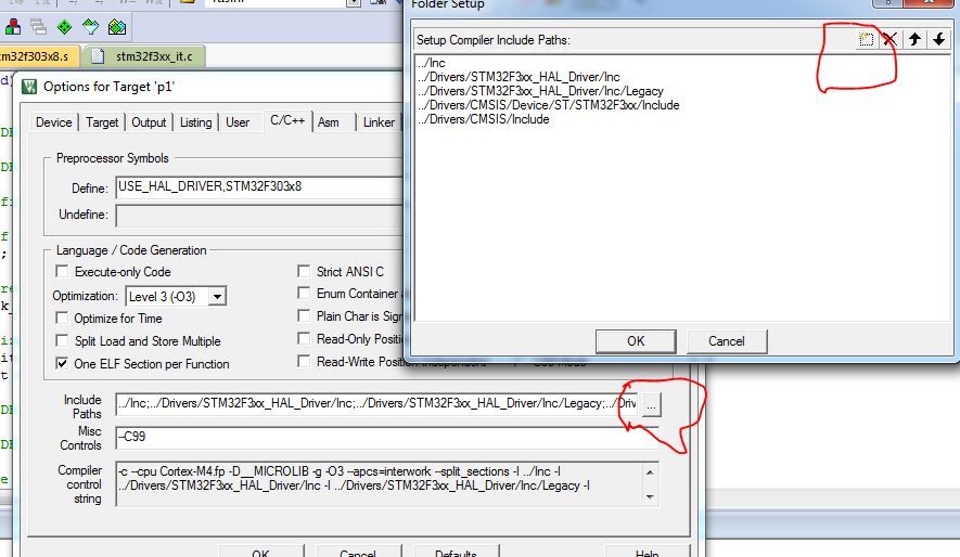

if that file '
CANtest1_STM32.h
' existe in your computer that mean you heve juste probem of link edition
did you have this file in your computer

Posted on August 17, 2017 at 17:11
go to : Flash - configure Flash tool - C/C++ - include Path and add the poth of the file
