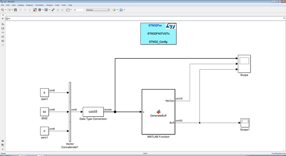

Here, I want to add more information about thetest model that is extracted from the example model, as shown below.

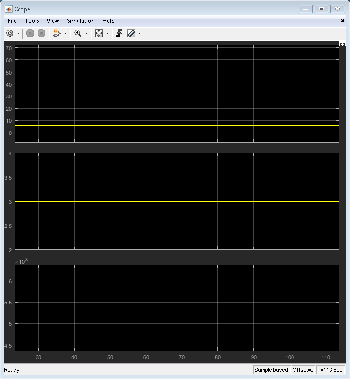

To analyze the output results of MATLAB Function block, I generated code for this model, ranit by using Simulink external mode and moniteredsignalesultsviaScope.
The1st channel shows that there are three data comming into the MATLAB Function block, i.e. 6, 64 and 0.
The 2nd channel indicates that there are totally 3 data that will be sent.
As for the 3rd channel, its output value is equal to 5368856 Does it mean the address of the buffer, in which the data are temporarily stored?By the way, dec2hex(536885648) = 0x200039
Thanks for any idea!

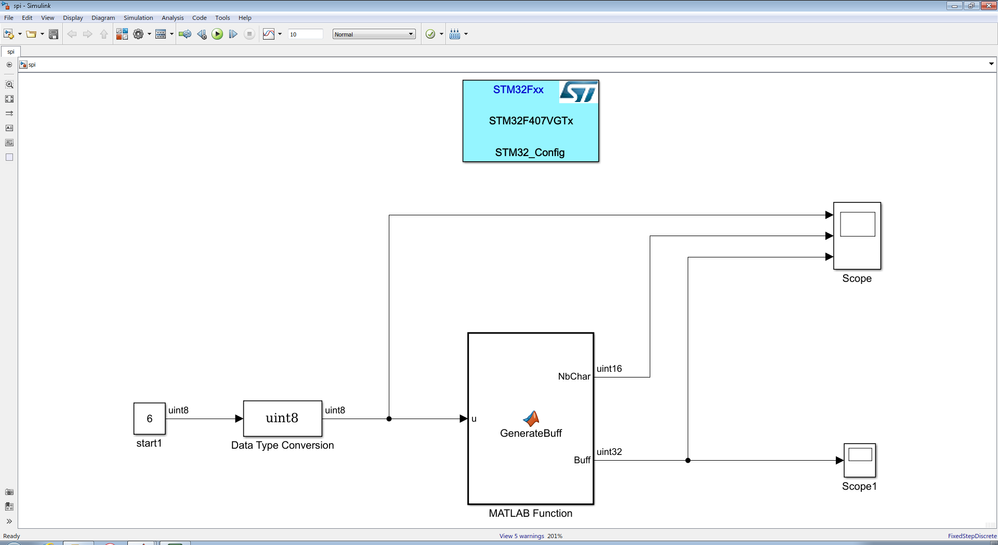

This time, I want to send only one number instead of sending three. So I just removed the other two constant blocks, as shown below.
However, when Keiliscompiling the generated code, two errorsoccur reporting that:
Error 1:
spi.c(54): error: #167: argument of type ''unsigned int'' is incompatible with parameter of type ''void *''
getBuffPtr(6U);
Error 2:
spi_data.c(35): error: #20: identifier ''P_spi'' is undefined
P_spi spi_P = { 6U };
I wonder if the example modelor the MAT/TARGET library that STM provides is ill designed? Such errorscouldmakemodel based design combining Simulinkwith STM32 MAT/TARGET Librarymuch more difficult.

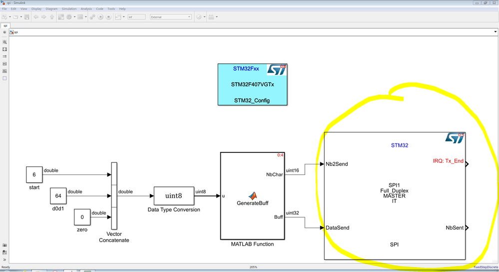

I tried to use external mode to moniter the activity of the SPI block. So I added an SPI block into theSimulink model, as shown below.But afterdownloading the code tothe board,simulink failed to connect to the target reporting a timeout error.
Does it mean that we can't use the external mode when the model has SPI block? If so, why?
