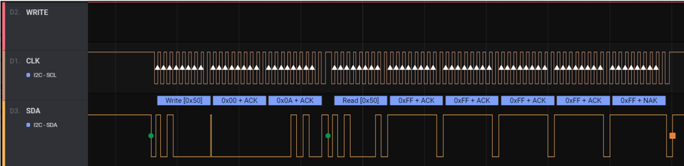

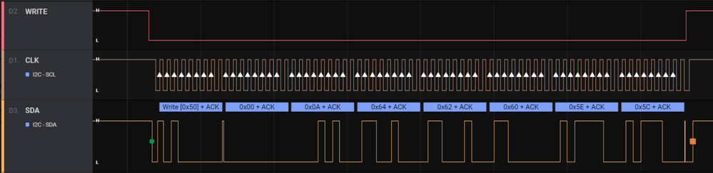

I'm trying to write and read to/from M24512-R EEPROM.
Seems that everything is fine writing and reading because HAL return is HAL_OK, but allways I've reading 255 value.
My code:

And attached oscilloscope images:
WRITE COMMAND
0693W00000CzlwvQAB.pngREAD COMMAND
I've checked all pins, VCC and E0-E2 are connected to GND.
Any idea of what I'm doing wrong?
Thanks in advantage.
PaoloValentino
Fixed it writting a HAL_Delay(10) after HAL_I2C_Mem_Write(). Seems WRITE pin wasn't in high level enough time to carry out write process.
