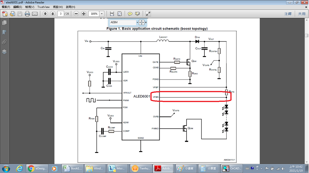

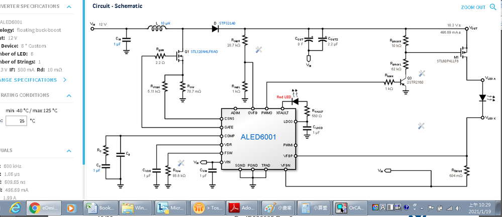

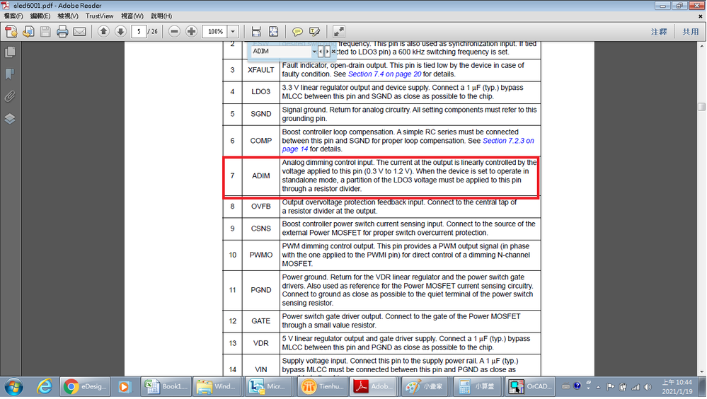

Datasheet does not show VFBN connect to Vin and shows ADIM need to connect to LDO3 or resistor to gnd. However, eDesignSuite schematic shows that. I want to know why . Could you help me to figure out these design? Thank you~

The datasheet describes ALED6001 in boost topology, while you are designing an application in floating buck-boost.
This is the reason why the schematics are different.

Hello @Patrizia BELLITTO​
ADIM: floating,=> floating buck-boost.
ADIM: connect to ldo3 or resistor=> boost topology
Am I Right?
I have another question how to set  ALED6001 eDesignSuite in boost topology?
Thank you.
Sorry but eDesignSuite does not support ALED6001 in boost topology.
