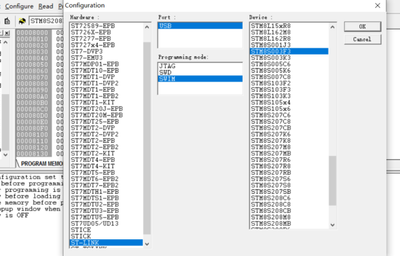

I would like to know where the configuration set in STVP is stored.
I'd like to set the configuration automatically, but I don't know where the default storage address is.

What do you mean with default storage address?
This is a question about where the Hardware/Port/Programming mode/Device values set in STVP configuration are stroed.
so that it can be read through the command.

The STVP settings are saved in the Windows registry, branch:
[HKEY_CURRENT_USER\SOFTWARE\STMicroelectronics\STVP]
Hope that helps?
