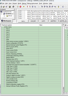

2024-11-06 7:33 PM
Thankyou. But how can I watch the register of UART2? I can only find UART1 in view > peripherial registers

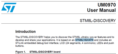

STM8L-DISCOVERY board only have USART1 because MCU is stm8l152c4.
2024-11-10 8:27 PM
Really? Maybe I used the wrong datasheet then
2024-11-11 10:36 AM
The MCU is stm8l152c6 but it only have USART1 as I said before.
