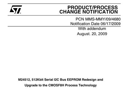

I need help to identify a 512 Kbit serial I²C bus EEPROM from the M24512 series.
I have two differents parts which appear identical, apart from one letter at the end of the reference : M24512-WG for the first one and M24512-WP for the second (photos attached).
Could some tell me what is the difference beetween the two parts ?
Thanks.

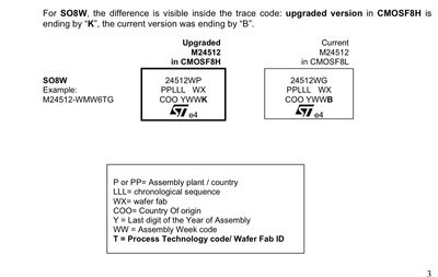

2024-02-21 12:21 PM - edited 2024-02-21 12:29 PM
Dear @pepito60 , @Tesla DeLorean ,
Here you go , we sent A PCN to our customers in 2009 on the difference with an upgraded design.
Let me know if it helps. and sincerely sorry for the experience you had . Merci depuis Paris :) Metro
Ciao,
STOne-32
2024-02-21 10:59 PM
Dear @STOne-32 ,
Thanks a lot for the information. I didn't have in my database the PCN MMS-MMY/09/4680 with the addentum, just the original one . The one with the addentum clearly explain the last digit.
Merci encore @Tesla DeLorean et @STOne-32
