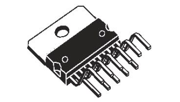

I am looking for compatible part numbers for ST part# 7004001 and Delco DM133, which I believe are obsolete.
The ST 7004001 is also equivent to Ford # N-7000420F-FB001
I also believe ST part# TDA7005 may be equivilent to DM133, not sure.
I am mostly interested in finding out what 7004001 is and get a datasheet for it so I can see if it can replace Delco DM133.
Appreciate any help on this. Thanks
Dan

You haven't uploaded a photo of this component, but if it really is one from STMicroelectronics, then it's almost certainly a customised device, and only the customer in question has access to the documentation. In your case, therefore, only the company Delco can provide any information.
How likely is it that a company would disclose its trade secrets?
Exactly.
I am extremely sorry that I am unable to assist you on this occasion.
Regards
/Peter

I mentioned TDA7005, when it is actually TDA2005.jpgTDA2005
ST part# 7004001 is not, as far as I know, a proprietary part. I have the specs for the Delco part. I just wanted to match them up. It looks like TDA2005 matches up to the Delco part, but I don't have that part in stock.
Searching TDA2005 produces the product page and datasheet which are still available.
https://www.st.com/en/automotive-infotainment-and-telematics/tda2005.html
https://www.st.com/resource/en/datasheet/tda2005.pdf
dcol
I have the TDA2005 datasheet already, I need ST part# 7004001 datasheet or at least a description of the part
