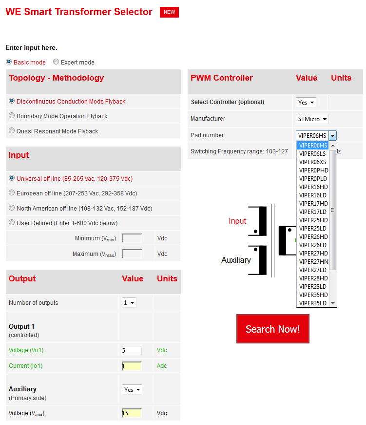

You may want to try out the online tool Smart Transformer Selector:
http://www.we-online.com/sts/

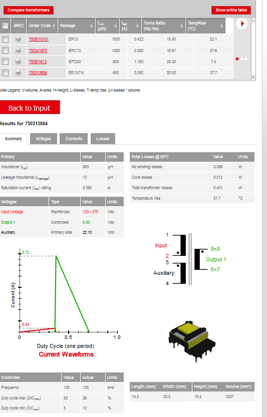

With minimal inputs, like input / output voltages and currents , switching frequency ... you could get access to an already design transformer that may work in your application. Here is one example:
If you find a transformer that could fit in your application, you can order here:
http://www.we-online.com/web/en/passive_components_custom_magnetics/university/students/studentsample.php
Hope it helps.

Posted on March 08, 2017 at 15:28
Hi Emil:
I already had an account with Wurth but did not realize they had a design tool.  I tried it but unfortunately I could not use an 'off the shelf' product.  I considered having them do a custom design but since this is mostly a personal project I did not want to use their resources.  I wish the tool would give suggestions even if nothing exact is available.
Thank You, I really appreciate your suggestion!
