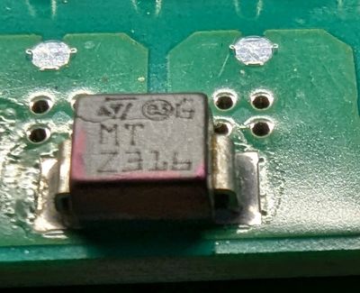

Identifying part (ST G MT Z316)
jazz-cam
Please could I have help identifying the component in the attached image to find a suitable replacement as it is shorted.
Many thanks,
Jazz.
SM6T33CA
SM6T39A - 600 W, 33.3 V TVS in SMB - STMicroelectronics
1 REPLY 1
SM6T33CA
