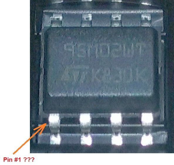

The M95M02-A125 has SO8 package. I can't see any mark or anything that shows which the pin number 1 is. I may suppose it's according to text orientation, but it's just a guess. So, the question is: how to know the right orientation of the chip?

I forgot to attach a picture of the chip. Is the indicated pin the number 1?
Pierre P.
​Hi,
Yes confirmed.
(pin 1 always near ST logo).
