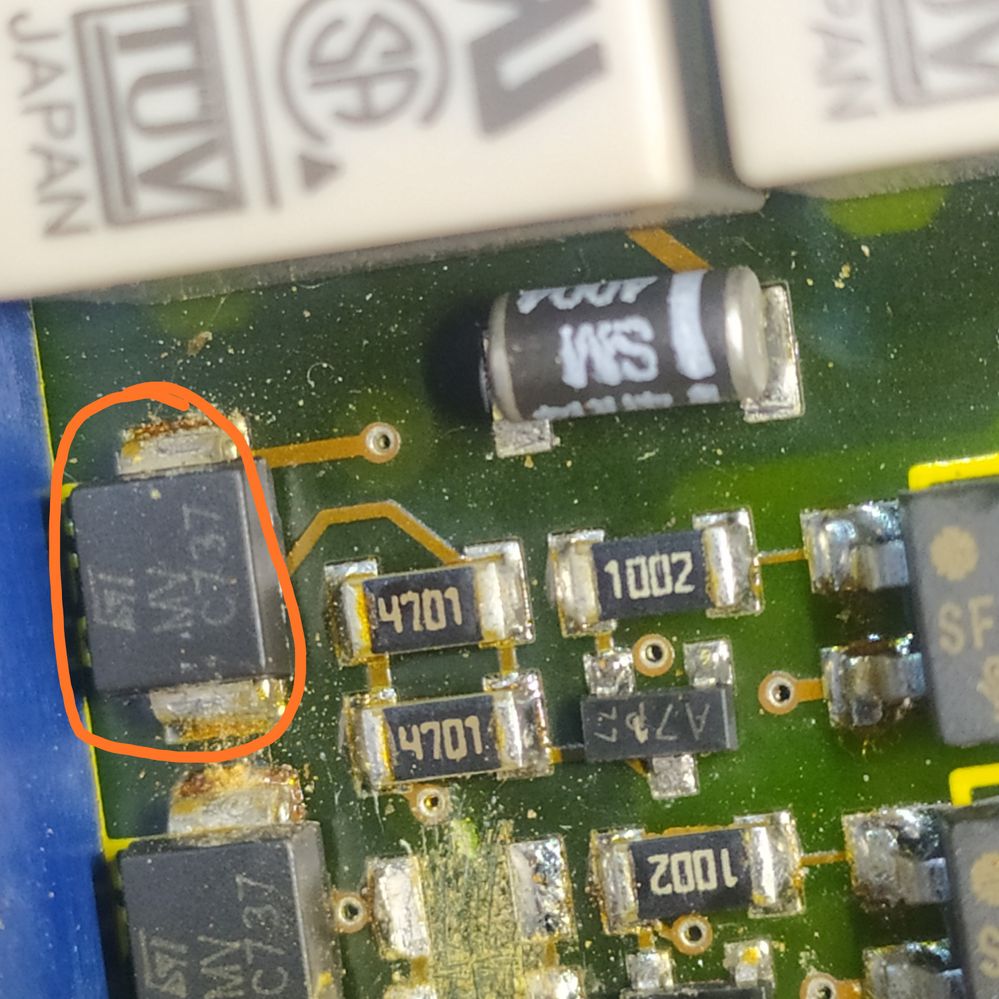

How to identify older components? Where to get datasheet of it?
APuzi.1
At the moment I have ST MV C737, how I understand it is zener diode, but no info in internet and here. Anyone can help to identify?0693W00000GX0SjQAL.jpg
SM6T36CA
https://www.st.com/resource/en/datasheet/sm6t36ca.pdf
1 REPLY 1
SM6T36CA
