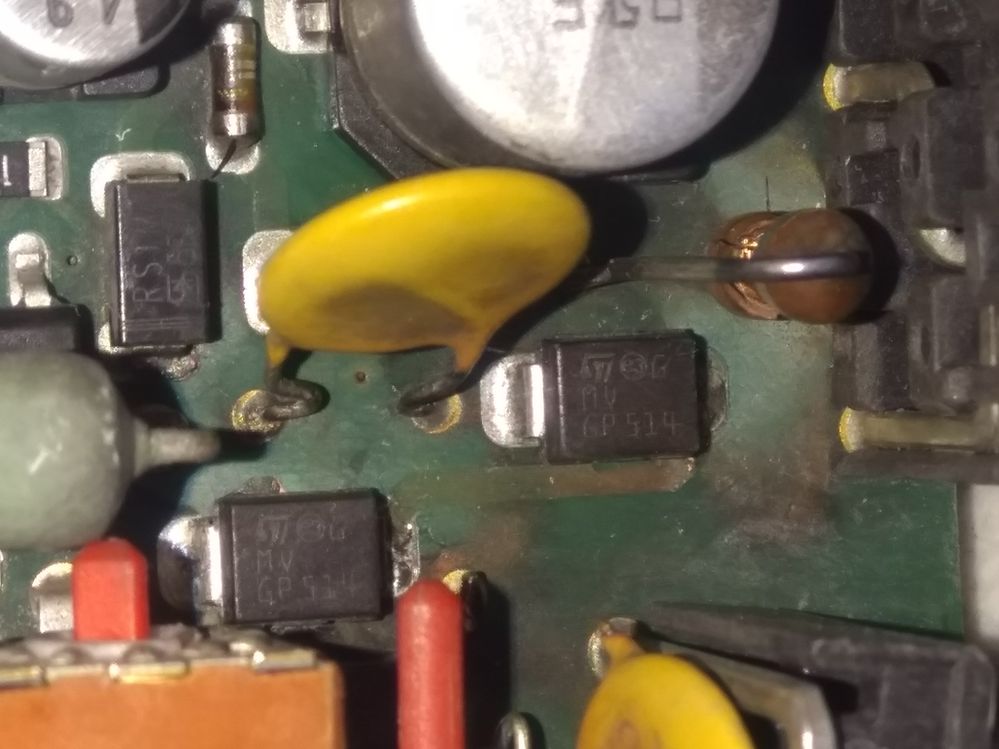

Hello Everyone, Could someone please provide data sheet about GP514 made by ST. It appears to be a TVS diode, but I would like to confirm with an expert. This component is a surface mount device. Thank you in advance.
PZuni.1
SM6T36CA
https://www.st.com/en/protections-and-emi-filters/sm6t36ca.html

That's not the part#
Show a picture, or list all lines on the part
Points for clear, in-focus, in-context
PZuni.1
Hello Tesla,
Please see attached the picture, it seems to be "GP 514" part number.
0693W00000QMsx5QAD.jpgThank you in advance
SM6T36CA
