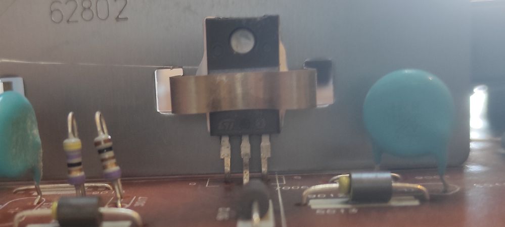

@Peter BENSCH​ Apologies for the delay, the image I can currently provide is not the best but hopefully it gives you a better idea of what we are dealing with. Also I realized I made a spelling error, the number is apparently 734, not 736. If a better quality image is needed I will disassemble the TV again to get a better one.
@JMala.3​ Thank you very much! I suspect that those are indeed the specs that I am looking for, only problem is that my part is a 3-Pin one which makes me skeptical. Perhaps I should have mentioned that in my initial post but take another look and let me know.

Peter BENSCH
Slowly we are getting closer to the matter, because it seems to be a component in TO-220FP (fully insulated TO-220) from STMicroelectronics. However, as I already wrote, the part of the marking visible under the bracket is only place and date of manufacture.
Now you could guess what the actual component marking is, which is unfortunately hidden by the bracket in the photo, but it should be quite easy to remove. It is probably a linear regulator L78xx, which is available in various versions - but you will only have the final confirmation after removing the bracket.
Regards
/Peter

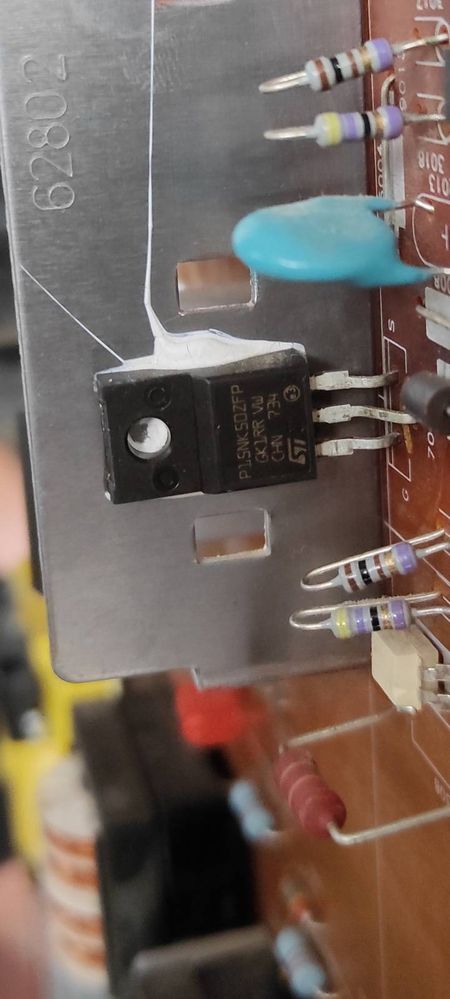

IZARI.1
@Peter BENSCH​ @JMala.3​
Greetings and thank you very much for all your help. As per Peter's suggestion I went ahead and removed the bracket covering the part number, so I believe we have found our solution. The part in question appears to be a P15NK50ZFP MOSFET N-CH 500V 14A TO-220FP. Attaching relevant photo for reference and I think we can consider this thread as SOLVED. 0693W00000WKLBcQAP.jpg
Peter BENSCH
Great, the hiding game has been resolved!
The component in question is or was the STP15NK50ZFP, already obsolete for some time. If you need to replace it, you could opt for the STP20NM60FP.
If the problem is solved, please mark this thread as answered by selecting Select as best, as also explained here. This will help other users find that answer faster.
