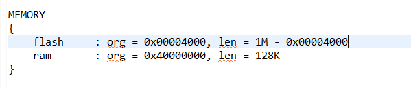

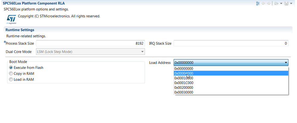

Hello everyone, I'm working with SPC56EL60L3 and SPC5Studio (v5.0).
I'd like to change the address at ewhich my application is stored in the flash memory, from 0x00000000 to 0x00004000, in order to place a bootloader in the first flash sector.
I changed the project settings as you can see in the screenshot
and generating the application code I got my linker file updated like this:
So far so good.

The aim of flashing the application starting from 0x00004000 was to place a bootloader application in the first flash sector. So now I need to flash this application in the first sector. how do I change the flash settings in the linker script? Something like this would work (the first sector is only 16 k long)?
MEMORY
{ flash : org = 0x00000000, len = 16K ram : org = 0x40000000, len = 128K}Thank you.
