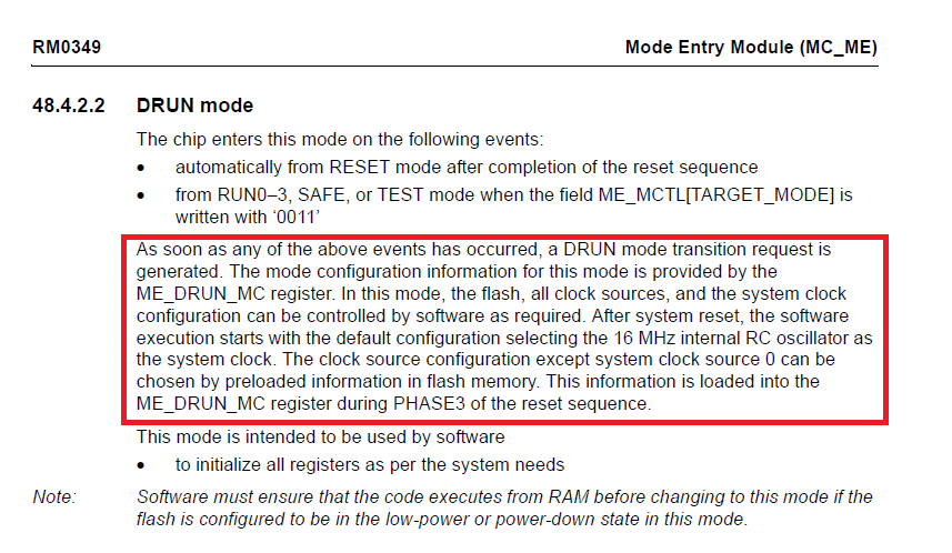

Hello Yalin ,
Could you check ME_DRUN_MC ?
it is maybe badly configured
Best regards
Erwan

2018-08-14 2:19 AM
Yeah, it was indeed a badly configured ME_DRUN_MC. Thanks!
