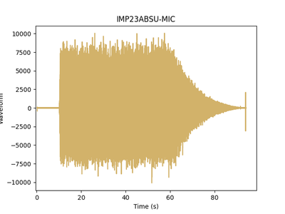

TomRett

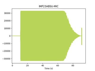

Thanks you! I receive a shorter amplitude range when i set the ODR from e.g. 192000 to 32000. Why does this happen? Here is the same procedure with ODR: 192000, ODRMeasured: 192000
 and below with ODR: 32000, ODRMeasured: 32000
We are working on patch releases for both FP-SNS-DATALOG1 and FP-SNS-DATALOG2.
By looking at your requests we found a bug in the software microphone setup we'll solve in those releases.
Updated versions should be online in a couple of weeks. I suggest to update the package and eventually come back with your further feedbacks.
