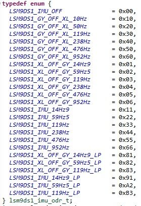

The output data rate that you sugested is not available for the LSM9DS1, since it only works with the gyroscope turned off, as you can see below from the drivers:
I did set to 59.5Hz since it is the closest data rate available for both accelerometer and magnetometer. I set the remaining values to the ones you indicated. Still, the issue persists and I don't really think it is because of the data rate.

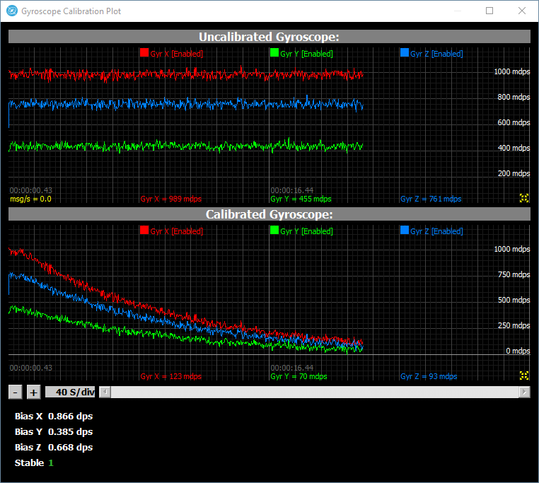

I don't think it's related to ODR either. If you also tried the thresholds in knobs and full-scale I recommended and it didn't help, you can try to store about 10-20 seconds datalog file including timestamp and send to me. I'll try to replicate the calibration with your data on my side. Anyway if the bias_update variable is always 0 it seems your sensor is not stable enough, as you already stated. It would be nice if you would be able to try another sensor, some newer model like LSM6DSO or similar.
