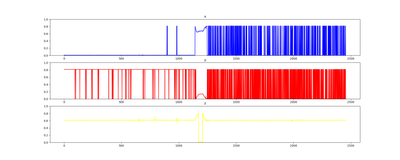

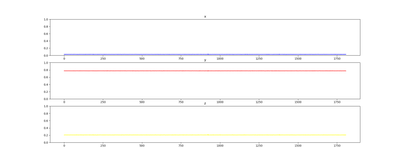

Spikes are present in the data coming from the LIS2DH12 accelerometer when placed in a casing, but when it is in the open there are no spikes. Attached is an image of the 3 axis data plotted from the accelerometer when placed on the table with casing and rotated. I have also added another plot of the same device on air (no movements). Please advice how to mitigate this issue. Thanks.

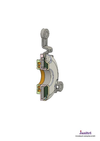

Can you give us more details about your casing? Is it possible that it is in contact directly with the top of the LIS2DW12?
Hello @Federica Bossi,
The casing/enclosure has no direct contact with LIS2DW12. It only encompases the entire device. There is nothing else placed above LIS2DW12.
Also, the casing is ABS casing, there is 5mm+ of space present between the casing and LIS2DW12.
Can you send me a picture to better understand? It is definitely casing related since without it no spikes can be observed...
I have added a picture of the sectional view which shows the casing for your understanding.
The green in the image is the pcb where the accelerometer in mounted.
Please note that there are 2 fastener at around 1-2 cm on either side of the accelerometer. Also, there is 5mm+ of space present between the casing and the pcb.

When you put the LIS2DH12 in the casing and it doesn't rotate, what do you see? can you share a graph?
In addition, can you write me your settings? ODR, FS, BDU...
Could be vibration. Have you rotated at different speeds? What is the spectrum of the spikes? Perhaps the enclosure has a certain resonance frequency that causes issues.
Also the data looks like it's a modulo of the real data. It overflows/wraps around. You can see that around t=1250 the x and y values slowly cross the boundary and then wrap around. If you remove the overflows from the data does it still have spikes? Or is it bouncing around 0.0/0.8?
Can you attach a csv file of the raw data? (integer not floating point)
