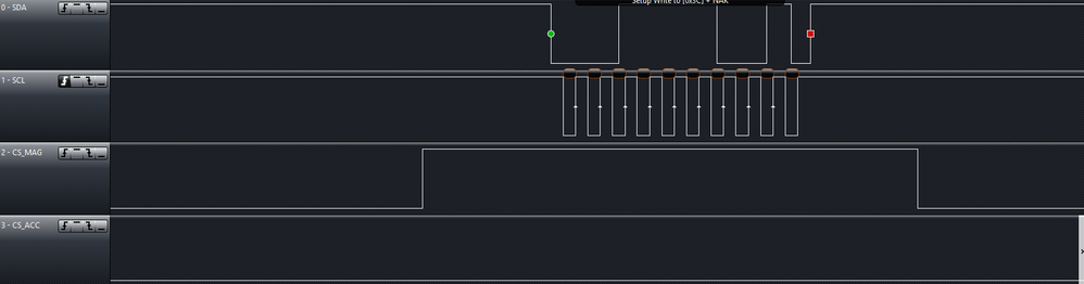

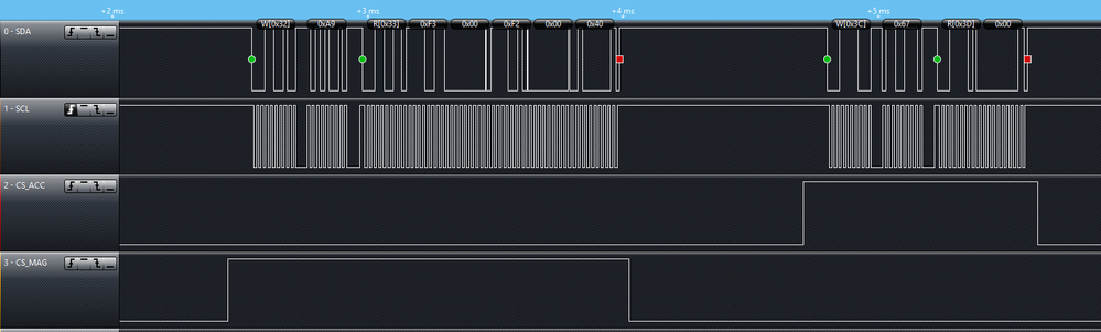

Once I remove two lines relating to accelerometer thresholds, then disconnect power for a while (must to be), it works again! I have checked all things on Logic Analyzer - I2C from STM32L011 works well too. With two thresholds lines there is no response from magnetometer (no ack to address).
It is a proper communication(without threshold lines)(CS_MAG should be CS_ACC):
This is ACK error when thresholds were stored (accelerometer works well):
