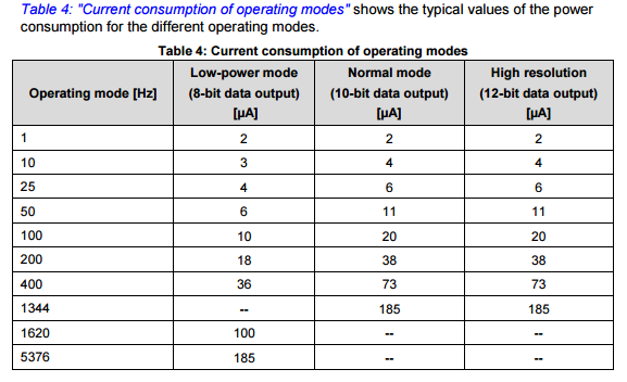

For current consumption please check the following table from application note.
Posted on May 25, 2017 at 15:36
OK, what I wanted to say is: The free fall abuse allows me to stay at 1Hz low power all the time, which results in 2 uA overall power consumption, regardless of activity or inactivity.
The Actvity/Inactivity detection as outlined above _automatically_ stays at 10 Hz low power, which means 3 uA in inactivity phases.

If you you want to use the accelerometer with ODR 10Hz the sleep feature will not give you any advantage.
This feature is useful if you want to monitor acceleration at 10Hz and increase the ODR if some significant movement happen. In this case you can set the ODR (> 10Hz) and enable sleep feature, then the sensor will automatically switch between 10 Hz and selected ODR.
If you want to reduce the power consumption you can use the ODR 1Hz but you have to switch to higher ODR manually (using a microcontroler).
