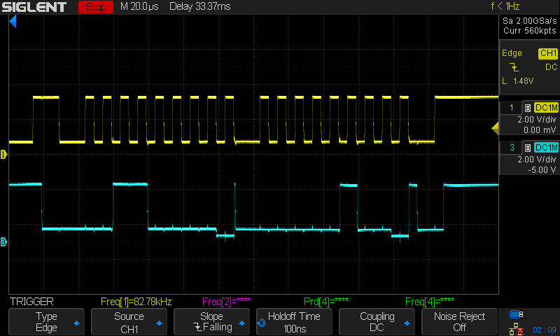

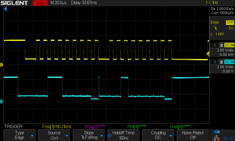

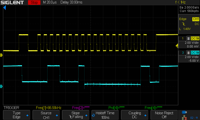

Actually, I found the issue. It turns out that the ST MEMS Zephyr module has a bug, at least for the LIS2DTW12 and the LIS2DW12. The following is from the LIS2DTW12. In the datasheet we see the following I2C sequence for register writes:
0693W00000NqxZfQAJ.pngHowever, in the Zephyr module, the sequence is
0693W00000NqxaEQAR.pngNotice the repeated START condition. This is verified by examining the code:
static inline int i2c_burst_write(const struct device *dev,
				  uint16_t dev_addr,
				  uint8_t start_addr,
				  const uint8_t *buf,
				  uint32_t num_bytes)
	struct i2c_msg msg[2];
	msg[0].buf = &start_addr;
	msg[0].len = 1U;
	msg[0].flags = I2C_MSG_WRITE;
	msg[1].buf = (uint8_t *)buf;
	msg[1].len = num_bytes;
	msg[1].flags = I2C_MSG_WRITE | I2C_MSG_STOP;
	return i2c_transfer(dev, msg, 2, dev_addr);
You see that there are two separate transfers. It is finally also verified by scope screens:
0693W00000NqxaTQAR.bmp0693W00000NqxbgQAB.bmp0693W00000Nqxc5QAB.bmp0693W00000NqxaOQAR.bmp
