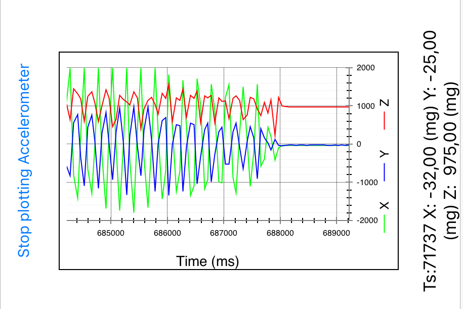

2) 20 g is too much, as you say, 2 - 3 g could be OK. I tried shaking heavily with a board with an
http://www.st.com/en/mems-and-sensors/lis3mdl.html
mounted and here is the result:0690X0000060737QAA.png
You can paste your sensor setup and output values to be checked by someone from ST. (Or if you can create a graph similar to mine from your output values during some operations, rotating etc.)

Posted on May 19, 2017 at 14:19
Hello Mohit,
The screenshot attached above is from a
http://www.st.com/en/embedded-software/bluems.html
, connected to a
http://www.st.com/content/st_com/en/products/embedded-software/mems-and-sensors-software/open-mems/bluemicrosystem1.html
expansion software. The software with source code can be downloaded freely at the bottom of the page (I haven't studied this code part yet, so I am afraid you will need to dive into that yourself.)
