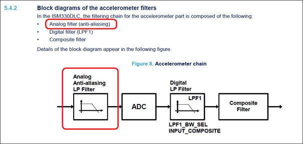

FPal.1
I would expect a signal chain for the IIS2 and IIS3 similar to this one....0693W000007DmSbQAK.jpg
Eleon BORLINI
Hi Joe @FPal.1​ ,
No, there is no analog anti-alias filtering just before the ADC of the IIS3DWB and IIS2DH.
In both cases, the mechanical structure of the accelerometer MEMS sensor acts as a low pass filter, preventing a significant fraction of the aliasing issue.
The fact is that the anti-alias filter is -at a practical level- limiting the bandwidth of the sensor, and for the vibrometer having a broad band (up to the 7kHz resonance frequency) is fundamental.
-Eleon
