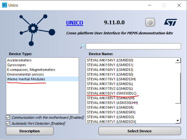

I bought a new ISM330DLC adapter board with the STEVAL-MKI109V3. Now I have connected the same to the eval board. Basically, I wanted to use Unico GUI to check the sensor data but I observed that the ISM330DLC is not listed in the Unico GUI.

Hi @omkardixi​ , did you download the last Unico GUI version?
0693W00000KbSW4QAN.pngI suggest you also to download the related firmware version on the STEVAL-MKI109V3.
/tim
Yes, this worked for me thanks a lot for the reply.
