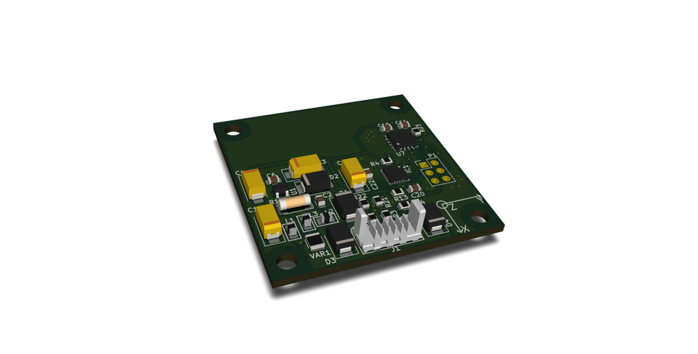

Dear all,
I'm writing .cpp driver for Arduino for the LIS3DHH but something seems wrong.
No replies from the accelerometer.
Do you have any suggestion on the SPI correct communication task reading my files?

I didn't have chance to try your code yet. But at first glance, can you please try SPI mode 3?
Posted on August 30, 2017 at 11:29
Hi Miroslav,
I've found the issue. It was a bad SPI writeRegister procedure.
Attached the files updated.
Now I'm struggling withe the interrupt 1 settings, but this is another
issue.
Thanks
Alessio
