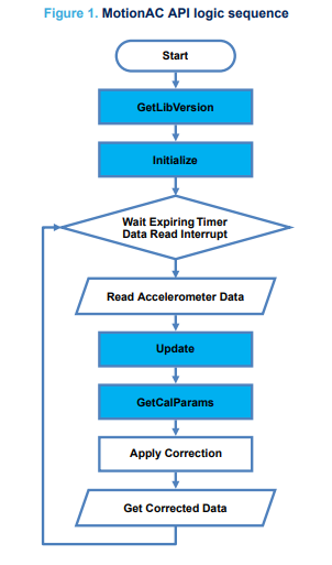

The central function that performs the calibration is this one:
void MotionAC_Update (MAC_input_t *data_in, uint8_t *is_calibrated)
*data_in parameter is a pointer to a structure with input data + timestamp, while *is_calibrated parameter is a pointer to a value which returns 1 if calibration is done.
