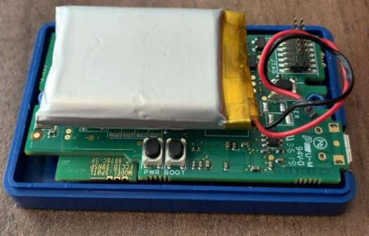

Hardware
An ST hat and the sensortile.box will be used in this tutorial to configure and develop an MLC algorithm with the LSM6DSOX MEMS 6 axis sensor. While the sensor fusion algorithm runs on the MCU of the sensortile.box.

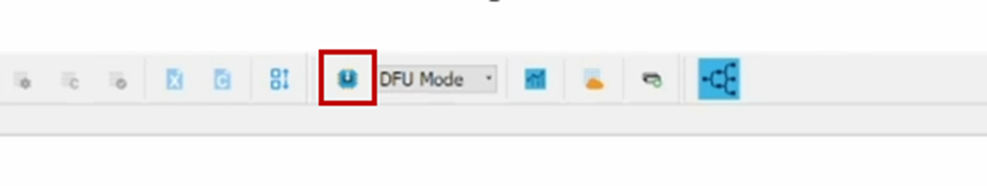

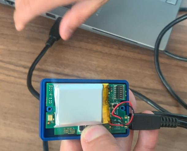

In this knowledge article, the board is used in DFU mode. To enable this mode on the board, it is needed to disconnect the board from the power supply.
Then, it is needed to press the “Boot” button and at the same time connecting the USB cable to the PC:

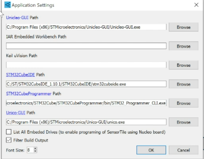

Setup AlgoBuilder
  • Configuration
As a first step launch the AlgoBuilder program and go on Application Settings and linking all the .exe files for:
  • Unicleo-GUI
  • STM32CubeIDE
  • STM32CubeProgrammer
  • Unico-GUI
  • Project Setting

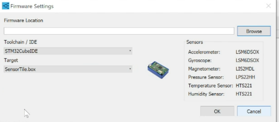

Then, it is needed to open the firmware settings selecting the project location, the toolchain will be selected automatically and finally the Target board to flash the firmware.
The target for this demo is the Sensotile.box.

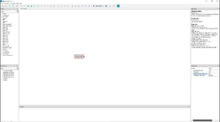

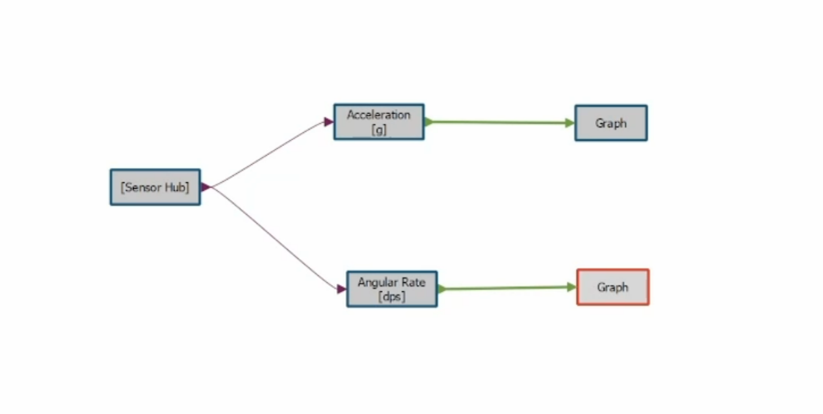

The first building block to use is the Sensor Hub block.
It is possible to change the properties of the AXL and the gyroscope:
  • 104Hz for both AXL and gyroscope
  • Accelerometer full scale: 16g
  • Gyroscope full scale: 500dps
Since the target is to get the data logs of both AXL and gyroscope, it is needed to add the respectively blocks.

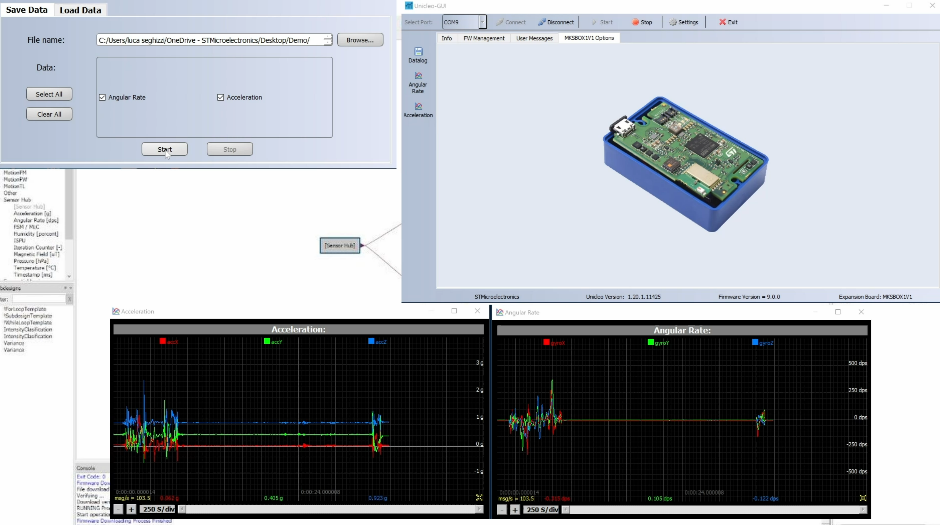

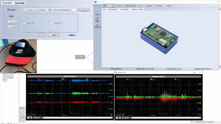

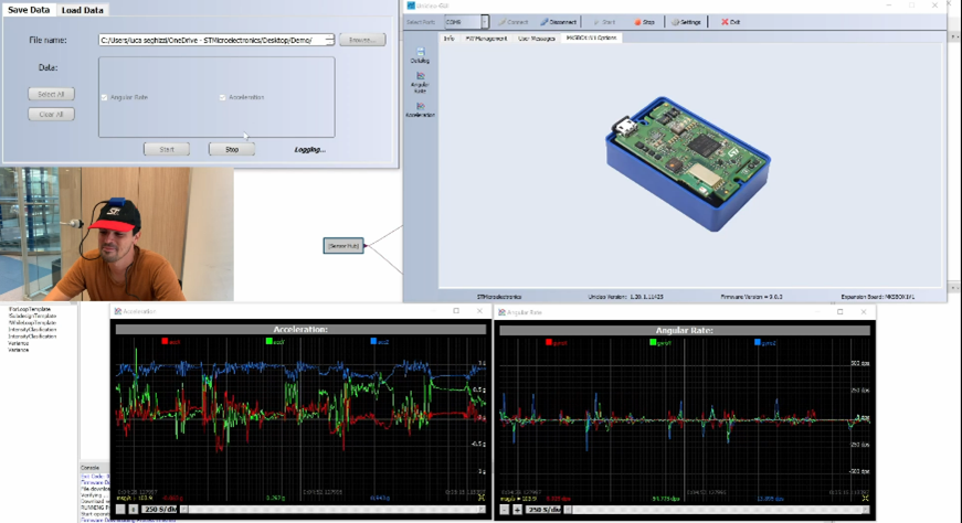

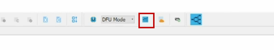

Once this is done, it is possible to build the firmware, upload it to the board by clicking open Unicleo-GUI by clicking on the icon below.
Once the firmware has been flashed in the sensortile.box. By clicking on the Unicleo – GUI icon
The SW opens and by clicking on Start and selecting the two graph icons and the data log icon like in the image below:
It is possible to:
  1. Check the Angular rate and the Acceleration data displayed with the respective axis
  2. Generate some datalogs of the Angula Rate, the Acceleration or of both. The data is saved as .CSV files in the selected folder.
Two classes have been recorded to be identified:
The Steady position getting AXL and gyroscope data when the hat is laying on the table.
And the Hat_On position getting the AXL, gyroscope data when a person is wearing the hat.

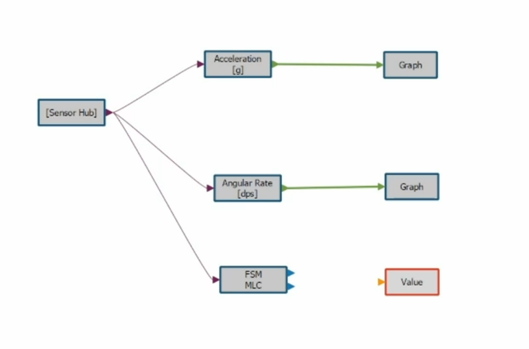

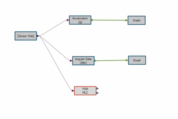

To create the .UCF file it is needed to add one more block to AlgoBuilder, the MLC/FSM block:

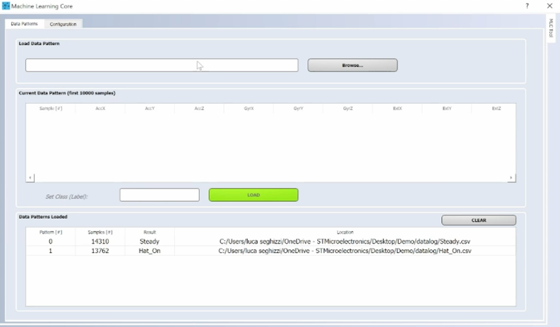

The next step is to import the data logs acquired in the MLC tool of Unico-GUI. In the "Data Patterns tab" of the MLC tool by clicking on the "Browse" button it is possible to select the corresponding data log files (multiple files can be selected simultaneously for the same class).
For all the data logs imported and for each class it is needed to assign a label, which is the class associated to that data.

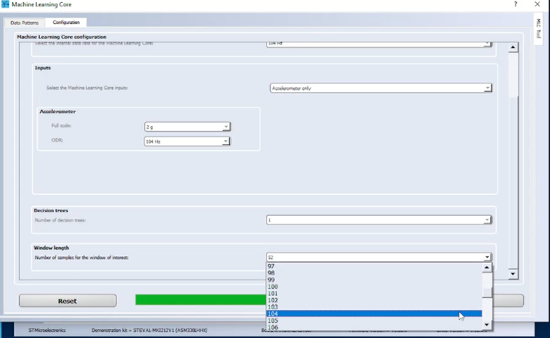

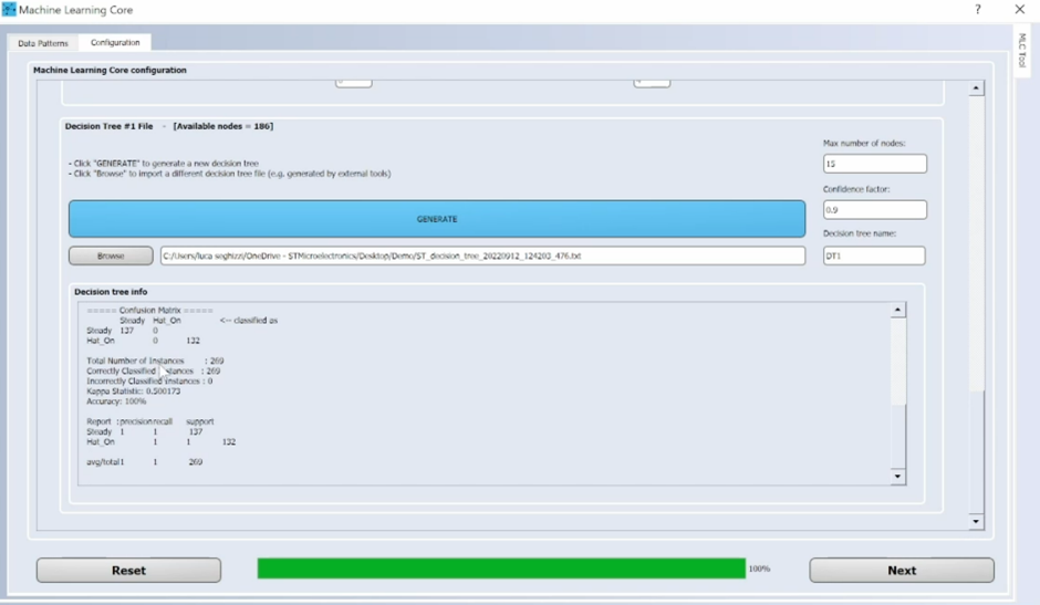

Once all the logs have been correctly imported, click on the “configuration” tab and proceed with the creation of the decision tree and the configuration file.

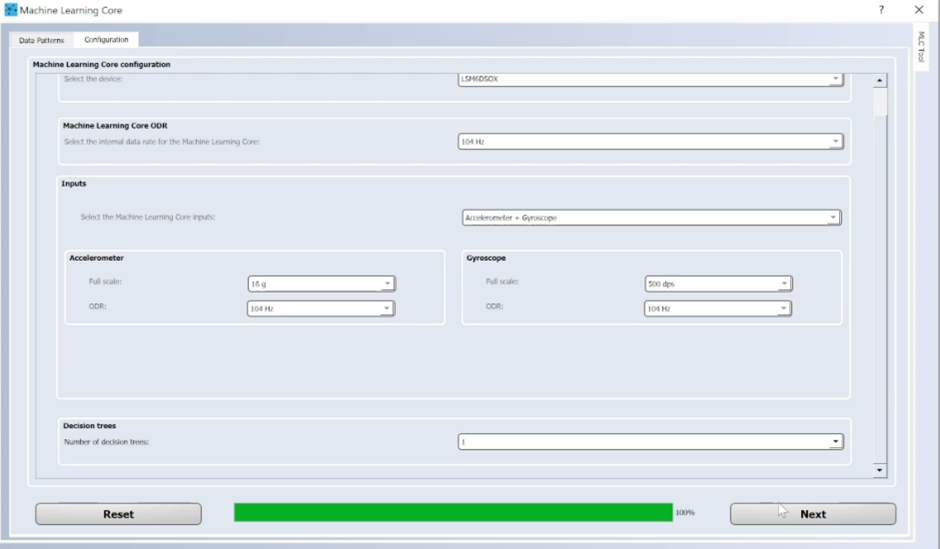

The configuration is for LSM6DSOX:
  • 104 Hz data rate for Machine Learning Core (which is the same data rate used to acquire the data logs)
  • Accelerometer data & gyroscope has to be selected accordingly to the parameters we used to get the data logs:
    • 16 g full scale
    • 500 dps
Then it is needed to proceed with the configuration by selecting 1 decision tree and a window length of 104 samples. The window parameter specifies the number of samples the Machine Learning Core elaborates every time it has to identify a class. It can be from 1 to 255 and the latency of the MLC results will be related to this number. In this case with 104 Hz data rate, and 104 samples in the window will get an equivalent time window of 1 second.
The filter configuration part is skipped for this example, that means that no filters are used on the input data.

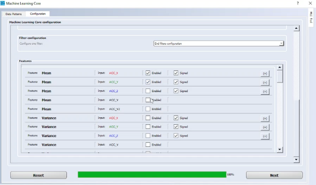

In the features configuration section, it can be select which feature to use when building the decision tree.
Since from the data logs it was clear that there were some variations on the accelerometer & gyroscope axes, it is possible to select some features (like mean, variance, energy, peak2peak) on these axes, and also on the accelerometer norm.
This is the step 3 of the MLC configuration procedure, where we are going to build the decision tree, which uses some of the features we have previously defined. We just need to click on the Generate button, or alternatively we can also import decision trees generated by external tools. Then we have the meta-classifier, it is an optional filter for the decision tree results, we can skip it for this example. Finally, we can generate the UCF file with the Machine Learning Core configuration for LSM6DSOX, to embed the decision tree in the sensor configuration.
Finally, by clicking on next it is possible to save the file .UCF to be implemented in our Sensortile.box.

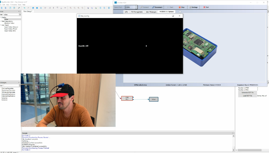

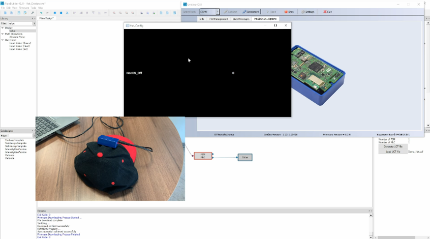

Closing the Unico-GUI, it is possible using AlgoBuilder to upload and verify if the ML algorithm works properly.
To do so, it is needed to add one more block to AlgoBuilder, which is the Value Block.
Since we need to display just one value, it is needed to set some parameters on this block:
  • Data type: Custom
  • Number of values: 1
  • Window name: Hat_Config
  • Value 1 name: Hat_On
It is now possible to build the firmware again and flash it in the sensortile.box. Opening the Unicleo-GUI and clicking on "Start", it is possible to immediately check the result of the implementation:
  • If the hat is on the table, the MLC output is 0
  • If the hat is on the head, then the MLC output is 4
