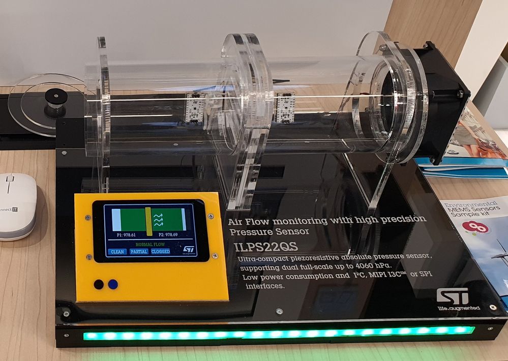

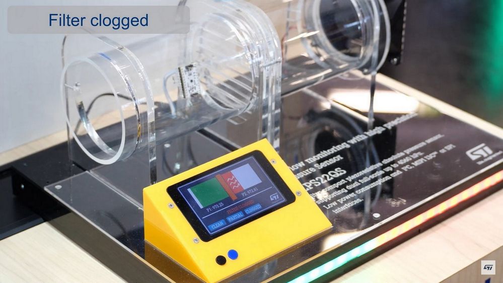

In this demonstration we can recognize condition of an air filter inside a ventilation system. The goal is to raise a warning when the filter is getting clogged.

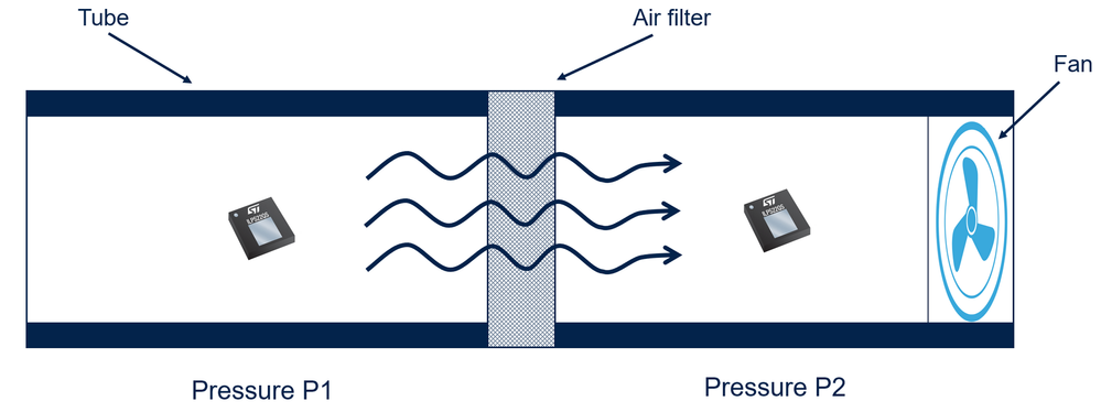

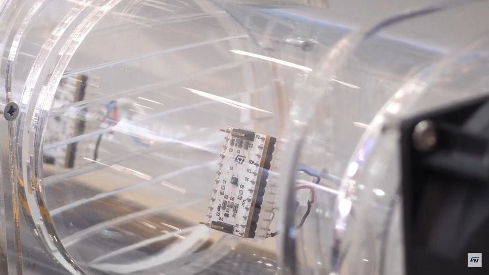

In the figure below you can see a diagram depicting the demonstration. There is a transparent pipe with a fan mounted on the right side. The fan is sucking air out from the pipe. In the middle we have two shutters to simulate air filter, one shutter is fixed, and one is moving using a stepper motor. Finally, there are two ILPS22QS pressure sensor evaluation boards each on one side of the air filter. Actual pressures P1 and P2 measured by the two sensors are shown in real time on an LCD touch display together with indication of the state of the air filter.
The two ILPS22QS sensors are mounted on ST evaluation boards STEVAL-MKI228KA.
Let’s have a look how is the demonstration working.

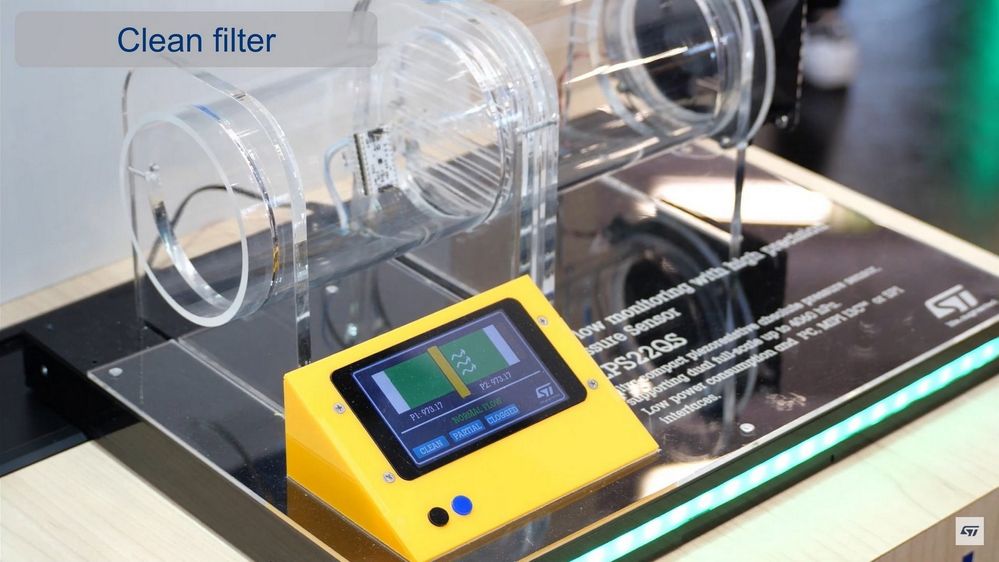

In normal condition, when the filer is clean, pressure P1 before the filter and pressure P2 after the filter are almost the same.

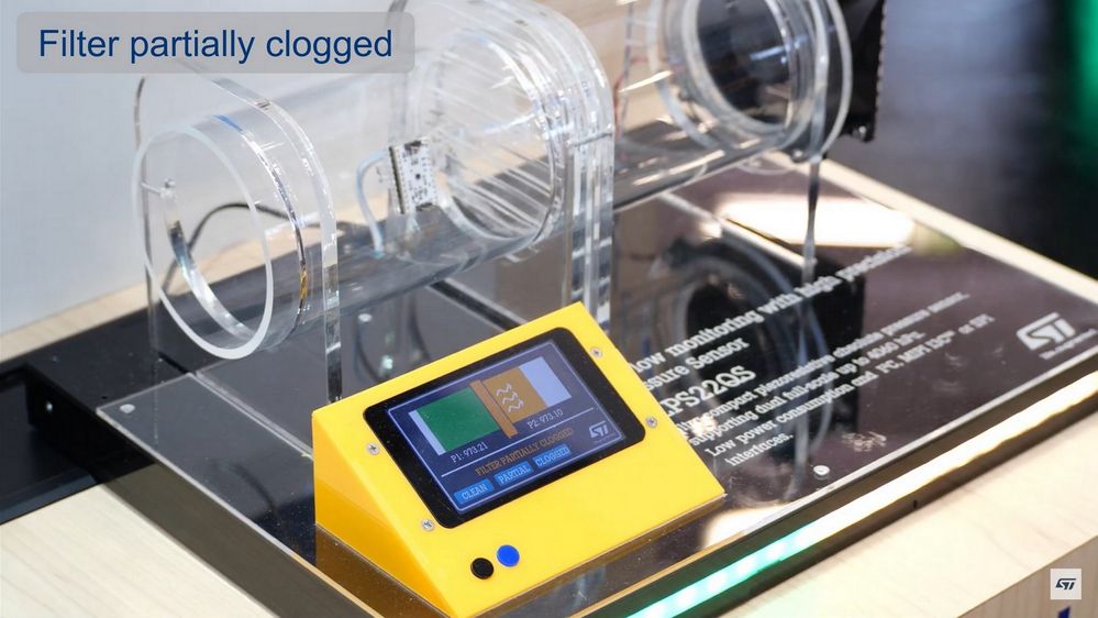

When the filter is getting clogged the pressure P2 after the filter starts to drop.
Eventually the filter gets completely clogged.
Even if the difference between the two pressures in our demonstration is just around 50 Pascal it can be well detected by the application thanks to accuracy of the sensors.
With the two ILPS22QS sensors we can recognize condition of the air filter and give an early warning before the filter gets too dirty.

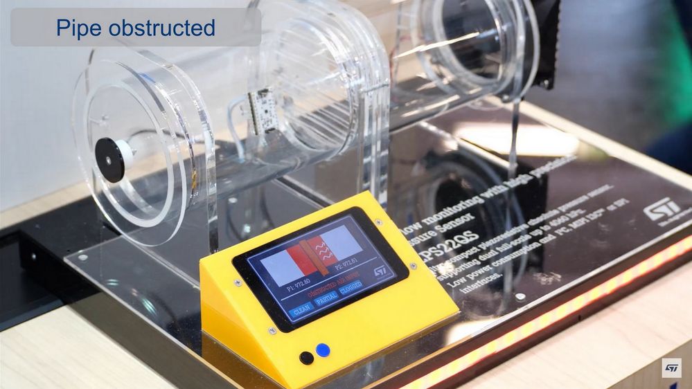

In this setup we can also detect an obstruction in the ventilation system as you can see in the picture below, where we have closed the pipe on the left side with a plate.
