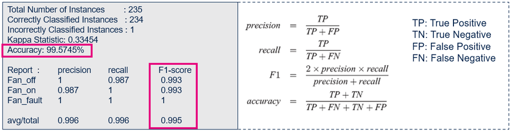

How can we know the decision tree model we have trained is good enough? There are multiple methods available to measure model performance. The most common Key Parameter Index (KPI) to judge the performance of a ML model is the accuracy calculated as percentage of correct predictions vs total number of predictions. Other metrics are available from different combinations of the basic elements, true positives (TP), true negatives (TN), false positives (FP) and false negatives (FN).
With these, it is possible to compute:
  • Precision: the ratio of actual positive observations to the total predicted positive observations
  • Recall (or sensitivity): the ratio of actual positive observations to all the observations in actual class
  • F1-score: the harmonic mean of precision and recall, often used as an alternative of accuracy.

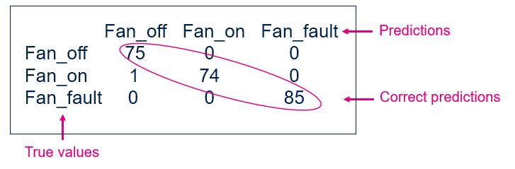

While the discussed KPIs summarize performance results, as an alternative we can also directly visualize the confusion matrix resulting from the testing dataset, as in the example shown below. The numbers in the diagonal represent the right predictions and need to be maximized, while all the numbers in the matrix outside the diagonal are errors in the prediction.
If there is a specific class that tends to be often confused with another one, it may be needed to re-examine again the training dataset used to find possible errors, or to revise the features selection.

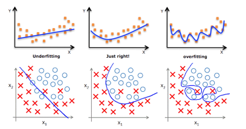

To guarantee a defined level of quality for the trained model, we are often trying to avoid the two most common causes of poor model performance: underfitting and overfitting.
  • Underfitting happens when a machine learning model is not complex enough or does not have sufficient information (in the selected features) to capture the relationship and information contained in the dataset and thus distinguish the classes. The concept of underfitting, good fitting (robust model) and overfitting is illustrated below.
  • Overfitting is a modeling error that occurs when the model performs well on trained data points but performs poorly on unseen data. It would have good accuracy on training dataset but low accuracy during testing or on another newly collected dataset.

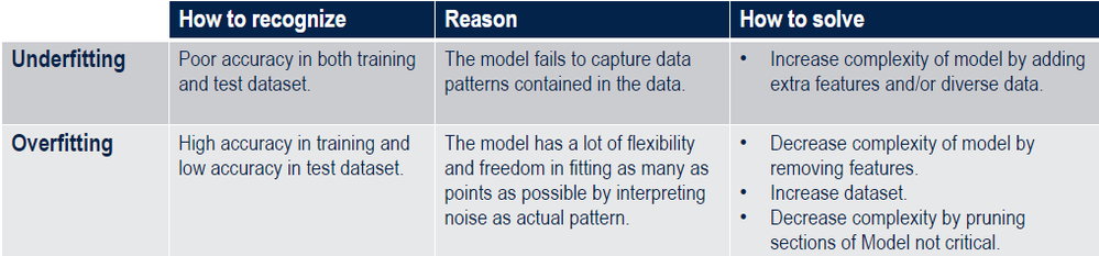

3.1. How to determine if the model is underfitting?
When the model is underfitting it fails to capture all data patterns contained in training data. In other words, if the trained model performs poorly both on training data and test data, then it can be due to underfitting. In this scenario, the selected features may not be sufficient to capture the information for the model to fit the data.
Underfitting is easy to handle, and the standard solution is to add extra features and train the model again. The other option is to reduce the number of classes. In certain cases, if data between two classes look similar, the model may not be able to do a decent job in classifying it. Adding diverse data may also be useful for addressing the underfitting issue because the model may be able to increase the complexity and learn the patterns that were missed in the previous training.
3.2. How to determine if the model is overfitting?
The overfitting model generally takes the form of making an overly complex model to capture features in data used in training. This situation arises when the model has a lot of flexibility and freedom in fitting as many points as possible by interpreting noise as actual pattern. Cross-validation generally helps in identifying the overfitting. When the distance between the accuracy obtained with the training dataset, say 95%, is high compared with what the model would predict for the testing dataset, say 50/70%, then it is a probable identification of an overfitting problem. The RMSE (Root Mean Square Error) obtained in K-fold validation is a cumulative error on the various folds on validation data. If the final model accuracy is good but RMSE is high (> 0.2), then it is a good sign of overfitting.
To address and reduce overfitting the following techniques can be adopted.

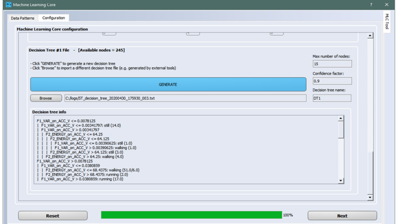

The decision tree algorithm inside Unico-GUI has the option for pruning. We can set up a limited number of nodes and the confidence factor would prune until we meet the condition.

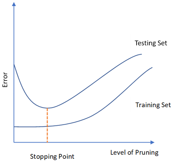

The approach to determine optimum pruning is through monitoring the testing and training accuracy. If we plot the accuracy/error of both testing and training datasets against the level of pruning, we tend to get a plot as shown below.
Without pruning, the model error on training data will be lowest but the error on the testing set can be high due to overfitting. As we increase the level of pruning, the error in the training set will increase, but the error on the validation set will start reducing because some of the nodes were overfit to the noise. As we further increase the pruning, the error on both validation and training sets will increase because pruning will remove nodes that are classifying correctly. This is the point to stop the pruning process.
An overview of underfitting and overfitting issues and solutions is summarized below.
