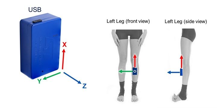

2 - Device orientation
The SensorTile.Box is placed on the left leg (see picture below). Other devices can be used as well, provided that the orientation of sensor axes is correct.
  • X axis parallel to the leg, pointing up.
  • Y axis perpendicular to the leg, pointing to the inside.
  • Z axis pointing forward.
