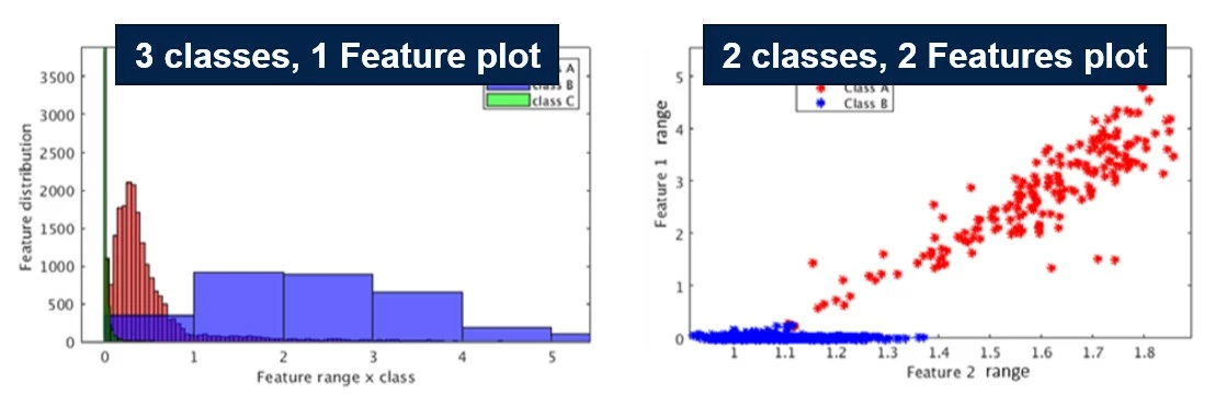

Visualization of computed features may help in selecting and dropping features to optimize the performance of the model. The information contribution from a single feature can be evaluated with a measure of how much different classes are separated. The analysis can be visually performed with 1D/2D representations.
The figure below on the left shows a histogram of a single features applied on a 3 classes problem. In this case, we can see that classes are well separated, hence the feature is a good candidate for model training.
It may be useful, when possible, to plot the Cartesian diagram of 2 features, like in the picture above on the right, where is shown a 2D plot related to a 2 classes classification problem and a selection of 2 different features. In this case, the strict separation is evident and thus the information from combining the selected two features is visible. This kind of plot is helpful to also evaluate the relationship between different features and classes. The figure on left side is plotting histogram of a single feature for each class. The distribution of feature value for each class is very different and even using simple thresholds the classes can be separated.

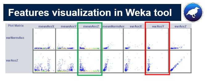

The same approach is supported by ML tools such as WEKA. The 2D plots shown below represent the relationship between different features and classes. In particular, it is possible to observe that the feature combinations in the green block show separability, while the ones in the red block are not.

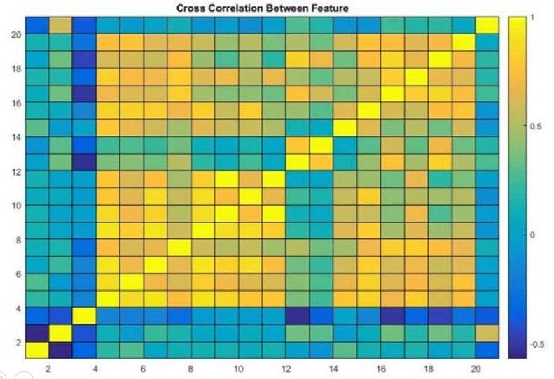

  • If the feature has a linear relationship or is strongly correlated with another feature, the information is already captured by another feature and hence this feature can be dropped. If this is hard to be visualized, the covariance matrix can be computed to identify the most correlated features. In the plot below we can see there are many non-diagonal elements which are strongly correlated (yellow) and hence they can be dropped.

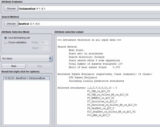

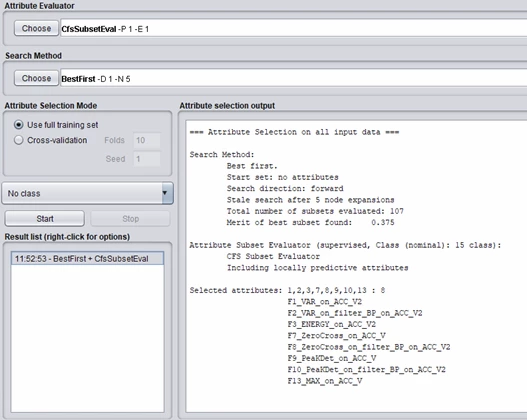

Finally, ML tools provide some built-in options to identify the best subset of informative features. Below an example is shown for the features ranking in WEKA. In the example shown, the problem has 30 features and by using feature ranking logic, Weka selects only 11 important features for the current dataset. It may then be a good idea also not to use them all but choose only the ones ranked higher.

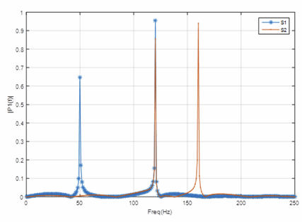

This process involves the selection of a proper filter (low pass, high pass, bandpass) and the definition of the cutoff frequencies. Consider the case of energy as sole feature for the classification problem. The selection of filter and frequency of interest is done by finding, with an FFT, the significant energy in the non-overlapping region between classes. The plot below illustrates the overlapping region and frequency region of interest for classes S1 and S2.
If we compute the energy on the entire span of frequencies (0-250 Hz), the risk is to collapse information for both classes. It may not be sufficient to separate 2 classes if the energy for different classes is similar in module but with different frequency distribution. The best option is to apply an appropriate filter to remove from the signal a specified frequency region before computing the feature.
If we take the example in the figure above and apply a low-pass filter at 60 Hz, the signal S2 will be completely filtered out and part of S1 which is below 55 Hz will pass through. Now if we compute the energy on both signals after filtering, S1 will have higher energy compared to S2 because the S2 signal is completely filtered out.
